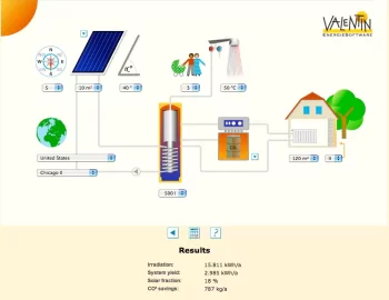

Try one of the solar simulation programs to show payback, output and ROI. www.valentin.de has this free simple calc, but not a lot of location choices.

You will need to know your heatload numbers to run accurate heating simulations.

Solar does work year 'round. And it doesn't need to be a bright sunny day. You want about a 50% solar fraction, the design programs will show the SF for all months of the year. Many areas see 80% SF in summer months, it may drop to 20% or less in winter. Across the 12 months 50% is do-able in most areas.
Plan on solar for DHW pre-heat in the cold months, possibly 100% SF in warm sunny months.
Contractors I know shoot for about a 30% SF when looking at heating loads, beyond that the $$ gets too large. And that's in the sunny SW.
