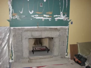

I have a new Morso 5660 w/blower that I am installing into an existing masonry fireplace. Due to the condition of the face brick, I plan on using firring strips on the face and covering with drywall. I will, of course, pull the entire firebox & surround out the 3 inches needed to keep the front flush with the drywall.
My question is how well will the drywall and paint withstand the heat of the insert? My drywall contractor stated that he would use a special drywall around and above the insert called firerock. I will keep the firring strips away from the insert and I will insulate any cavity surrounding the insert with rockwool or similar material.
Please comment, thx,
DJ
