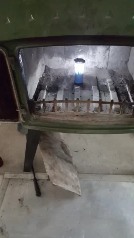

Does anybody have a picture of how to install or what the heat baffle looks like when it is installed I'm doing battle with one of these please help much appreciated
I'm new to this morso 1125 and am trying to install the heat baffle I would appreciate any help thank you
