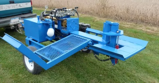

I threw the $2k number out as level where you can build your own splitter pretty easily. Most all of the horizontal / vertical units are under that as I stated. At least we agree on that. The cheapest way to get a basic splitter is to buy it.
Now my homebuilt unit DID cost under $2K with a log lift & a 9sec round trip cycle time. All hydraulics were new and steel was purchased from the local scrap yard. I have ~$2.5k in it now with a hydraulic 4 way wedge. Can you buy one off the shelf for that? No you are looking at $5k+ The only segment of log splitter where you can build more inexpensively than buy is the optioned out commercial splitters.
Just looked like you were contradicting me when we pretty much said the same thing.
Don
