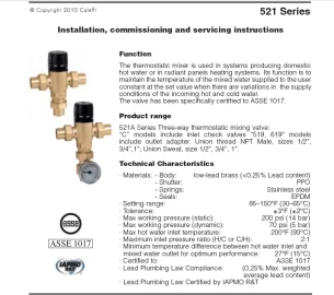

I have a watts mixing valve that says 100 to 140 deg. It will allow what ever temp water I have In and can be reduced by 40 deg. So If I have 180 F water I can mix It to 140 F . Is this valve made for 140 F water max or is it just not working right ? I wanted to use it for a radiant floor but thats to hot.
