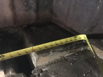

Finally pulled out the insulation and have some better photos. This is the spot where we want the stove, it's the middle of our living room.
  • Missing anything? Rear flue into old gas fireplace firebox and out chimney?
What you have is a heat form fireplace. It’s a metal firebox in a masonry structure. If you tear the sheet rock back to obtain proper clearances around the opening, there’s no reason you couldn’t make this work.
