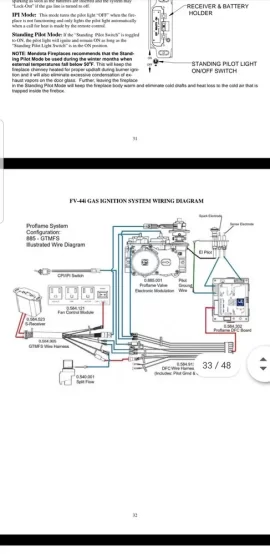

I have a Mendota FV44i gas fireplace with remote. When I plug in the battery back up, the fireplace is operating as expected, but without the batteries, the receiver seems to not be registering a signal from the remote. I have confirmed that the master switch is set to ON and have tried toggling it to off for a few seconds before putting it back to ON. I've also tried pressing the sync button quickly and releasing it, as well as holding it for 7 seconds and releasing it. The receiver did not beep after either attempt.
Any ideas on how to fix this issue would be really appreciated!

Did either one of you get a resolution as I have the same issue. a Mendota dxv35. I've had it for 4 years. first year worked as expected, second year halfway thru winter, stopped working and only would work with backup batteries. This year was working and went to change batteries and it wouldn't light, no pilot. I suspect when I opened the door and moved things around, I might have stirred up dust into the pilot light assembly, so most likely separate issue than the battery backup. We did check and there is power to the unit. We checked by using an extension cord to the outlets within the unit and the blower went on.

First step check outlet inside firebox, could be tripped breaker or sometimes they are switched via that switch on the wall you never knew what was for.
Second check power out of transformer. Check for any loose wiring connections on the control module. If nothing changes and you do have power at the outlet, then I would put a new transformer and control box in, I would add a $15 surge protector while at it.
Ok these SIT 1 systems are easy. Make sure the FCM is plugged into a good outlet. Make sure FCM is turned on. Make sure the small COMM wire from receiver is fully plugged into the FCM! Test voltage coming out of it. And then make sure all wires are firmly plugged into SIT board. And definitely add a surge protector.
