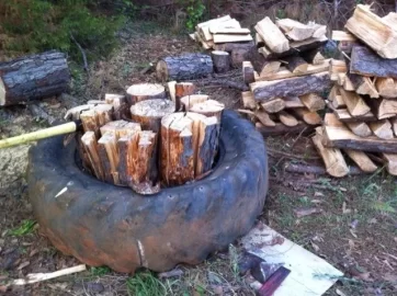

That large rear tractor tire is 28". I had the tire and splitting to do yesterday, so I gave it a go. If you look at the picture- there are about 8 rounds around the perimeter. The center round wasn't split out of respect for the handle. The center round is just there to take up space. The technique is great for the smaller rounds <10". Larger rounds can be made into smaller splits before loading the tire. I left myself plenty of room around the tire and moved myself around the perimeter. When the handle did hit the tire, it never bounced. I suppose it's because the tire has no air pressure. When the handle hit the tire it made a cool sounding "thud" noise, and never felt dangerous as the force was absorbed not deflected.
There is an aluminum piece of sheet metal under the rounds which I put down before setting the tire on top. When the maul failed to make a split near the center of a log, I found it worked well to make a split near the outside edge. Aiming for the edge is a bad technique when using a chopping block, but works great when using the tractor tire. The maul never hit the ground as it often does when using the old standard chopping block with round to be split resting on top. The large tire is easily rolled around for short distance transport or moved by tractor for distant outings. After my experience yesterday, raising rounds to balance them on top of a chopping block might be a rarely used technique for me in the future. Larger rounds >10" are made smaller using a triangular wedge struck with the hammer side of the maul.
A hydraulic splitter is on my "to build" list, as I already have the parts.
I like manual splitting when it goes quickly and safely. The large tractor tire helped to accomplish that.
