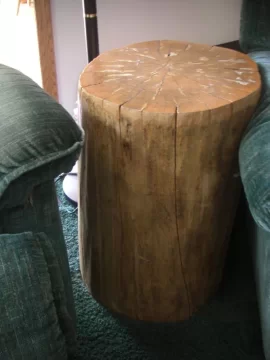

I doubt you can actually prevent cracking by just sealing the ends. Check some wood turning sites on that topic.
Some species will hold their bark, others will fall off. Some come off easily when they are green. You can try bashing it for a while with a heavy rubber mallet.
A spud will take off the bark. I'm not sure how you could stop it from checking. Maybe bore a small hole down the center and plug the ends when the round has dried.

As far as checking...I'd let it check. If you want a dead smooth top on it, maybe have someone cut you a round piece of thick glass with beveled edges that would overhang the edges of the round by an inch or two. Or make yourself a similar top piece out of wood - maybe find some interesting heart wood or something for an accent. Plus, with a seperate top you could shim it level and eliminate any imperfections in your saw work...not that there will be any of course.
my parents have a "stump" end table. I looks similar to the one in the pic, The top is sealed, it is cracked/split on the sides, but works fine. It's at least 30 years old
I had my mom snap a pic,
The top could use a sand and reseal
