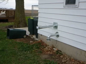

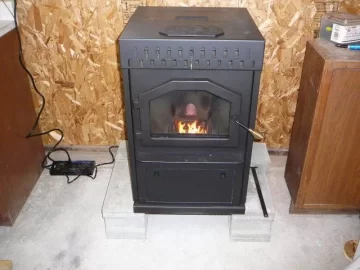

Received and installed Thursday. Played around a little Thursday night learning to tweak fresh air draft, etc. and started a long test burn yesterday at about 3:30pm. Goal of the test is to see how many hours it burns without attention and how long one hopper of fuel lasts. Fuel on this test is corn/pellet mix 50/50.
Overnight low just 44deg here but strong winds 20-30mph. Garage temp started at 57deg at light up. It was up to 65deg by 5:00pm and maintained that all night.
It's my first install on my own and it could probably be better, but it's working. I may indeed still change venting to outdoor vertical rise to get it above the window. Vent and intake are facing east which gets the least amount of wind so maybe it'll work. Right now vent has a slight drop as it runs horizontally...probably not a good thing but hopefully not a deal breaker with the short run and OAK installed.

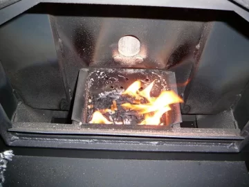

Here is a quick snapshot with the door open at 14hrs of burntime. After picture I used the scraper and stirred the pot and this lowered the level considerably.

The only ash that will be in the pan, is the fly ash that is ejected by the combustion air for the pellets. As the burn pot sits inside a liner, and is enclosed to keep the air coming in through the holes. More combustion air (open damper more) may solve your problem. The pellets need more air to fully burn. Should not be a pile of unburnt black pellets.
Thats what my buddies burned like, even with the damper opened all the way. To many holes in the burnpot above the pellets. The majority of air should be coming in through the bottom of the pot, to ensure proper combustion. He used to use the tool and just pull some pellets out of the pot and drop them in the ash pan. He had to do that once a day (at least/depending on heat setting).

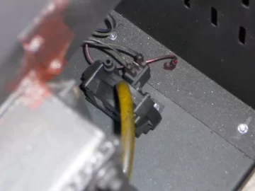

Okay...looking for somebody who will take the time to look into the back of their Baby for me. The #2 blinker indicates the stoves vacuum switch has tripped.
I opened up both sides and found that the vacuum hose is hooked up, but I found two wires that are NOT hooked to anything. One red wire laying near the vacuum switch box...and the switch having the center terminal with nothing attached.
The other...well I can't find anything else with an empty terminal.
Can somebody confirm this red wire goes to the center terminal on vacuum switch, please?

The red wire is for the ignitor (according to the manual schematics) my buddies is not hooked up either (got off the phone with him). If pellets are building up, it needs more air. But if its shutting down by adding more air?? Then I am stumped. Other than a faulty switch.

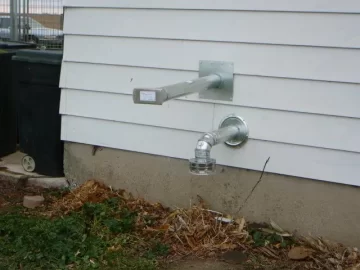

If that vent in the picture you provided isn't up bubble at least 1/4 " per foot you have a potential for over heating your venting system.
According to the manual: "The #2 heat level light is flashing- The stove’s vacuum switch tripped."
I can rest my hand on vent before it runs through wall thimble. Wouldn't it be really hot if that was it?

Your wires are correct. Two gray wires with the middle terminal empty. One terminal is common, one is normally open and one is normally closed. You need the common and the normally open so that the switch closes when the fan starts. The red wire is for the ignitor if you had one, I believe. I'm beginning to think you have a defective switch. I think I would try jumping out the switch and then open the damper to see what the fire looks like. If it looks good and active then for some reason the switch isn't working properly.
