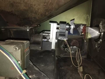

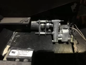

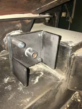

This Magnum 7500 was not feeding pellets consistently with the old Auger that has the tab end that sits between the ears of the auger motor shaft collar. Sometimes the pellets push the auger out away from the motor because there is no physical connector holding the auger motor shaft to the auger!
Therefore we installed the new auger and bracket upgrade kit.
Has anyone ever done this? Seems to work better.
Pic 1 - Old Auger, Bracket and sluggish Auger Motor
Pic 2 - new auger, bracket, and nylon bearing installed
Pic 3 - New 8 RPM auger motor installed

Hello
