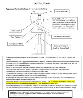

Did a new build during the summer and had Excel square support box with 11' of class a Excel pipe installed through 2x12 rafters in a 10/12 cathedral ceiling about 16' off the floor. So there i am with a beautiful flue extension just waiting for the smoke. I picked up a Madison (50‐SHSSW01) yesterday and now I see in the manual that "In the case of cathedral ceilings, the prefabricated chimney system should extend to 8.0 ft. from the top of the unit."
So i think I'm in a bind here. I'll need about 12-13' of pipe (using durablack single wall) to get up there and there's no way (that I know of) to extend the class a down to attach the pipe. The flue extension sits in the bottom of the box with the chimney attached.
Now what? help? I'm looking at this from a local authority standpoint. I figure it will work fine.
TIA
David
