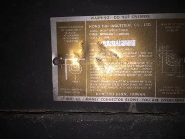

Hello, I’m new and this is my first post. I’m looking to put a wood burning stove in my basement (I live in SE Wisconsin and have a forced air furnace and a fireplace). I have an available flue because I replaced our traditional water heater with a PVC vented one and freed it up.
My family has always had a fisher mama bear in the basement which has heated our house for the most part.
However, I don’t think I’ll be able to convince my homeowners insurance to approve a non UL listed stove.
I was over at a friends house and they had this stove in their basement. I took a picture of the tag but not the stove. I can’t find any info on it anywhere and am wondering if anyone knows anything about it? Is it UL listed?

If it is an older stove it could be a Scandia. But Scandia have their name on the front, most of the time.

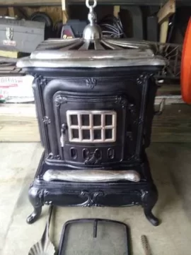

Post a picture of the full front of the stove.
there a model # on that tag. that would help looks like a vogelzang copy of a antique stove

It looks exactly like this! Would this be considered a UL Listed stove?
I dont see any testing lab listed on the tag so by that i would say no. If there is a lab listed and it is acredited then yes but it still is not a stove i would consider installing in my house.
