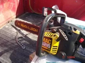

Here's mine clinder is perfect and looks pretty new. Ported and muff modd. very quick 2-3 cuts at a time but better than it was before porting lol
  • [Hearth.com] MAC 160s Wont pull
