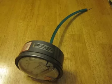

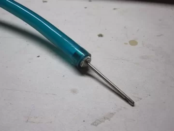

Reading the manual for setting the slide damper on an M55 insert and it says to use the 1/8" hole at the top right corner of the door. The hole above my door is not threaded so how have you M55 owners connected to this? I have a Dwyer 0-.25 gauge off eBay to use for the task. Would using tygon tubing and pressing it to the opening be enough?
