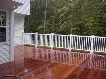

I built my deck about 10 years ago. The support structure is regular pressure treated lumber. For the decking I used Ipe (Brazilian walnut, same fire rating as concrete and steel, one of the only woods that sink in water immediately, life is excepted to be 50 years, the pressure treated lumber will rot out from under it before it goes bad, so hard you have to use carbide tools to cut and drill it, and you have to drill it to screw it....really amazing stuff....they are using it on the boardwalk in Atlantic City these days...just goolge Ipe). The Ipe only added about $700 to the cost of the deck. The Ipe weathers to a silver color but if you pressure wash it reverts to the brown for a couple of months before the UV weathers it back to silver....so I usually just leave it silver. For the railing I decided to go with this vinyl, it's internaly lined with galvnized steel, I can't remember the name but it was the standard stuff they were selling at Home Depot. I have to pressure wash it about every one to two years because of mold growth (I'm close to the woods) depending on if I treat it with an anti-fungicide spray. HAve had zero problems with it.........
