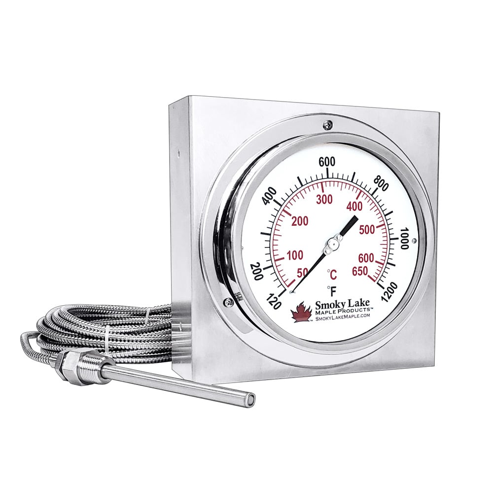

There was a time when you could buy mechanical water temperature gauges for your car. It used a bulb on one end of a tube that would be set in the hot water and then the expanding liquid would push the needle up on the gauge which was at the other end of the tube. All mechanical.

Now I am wondering if I can hook a Type K magnetic probe cable to an analog thermometer and place the magnet higher up the stove pipe...has anyone seen this setup before?
I have a probe installed in a single wall stovepipe. Works great. It is the thermocouple for the auber meter which looks a little "lab like" but could be hidden away in the fireplace up high for you. The thermocouple wire is a thin braided stainless steel wire that is quite long.
I really like the utility of the thermocouple probe. Fast and accurate readings with an overtemp alarm.
In my house stove I have double wall pipe and a mechanical probe that is slower but also tremendously helpful.
I put the thermocouple on the back of the stove pipe when I replaced the pipe last year. It's practically out of sight now.
