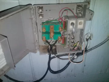

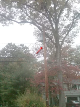

Click Pic to enlarge
Pic 1 - Outside network box on house
Pic 2 - New telephone pole within the last year but phone line is old.

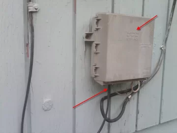

Well, Fairpoint came and checked the pole connection and the line to the pole. Then he said it was the house wiring. So he left and I did more testing on the house wiring. I found no problems with the house wiring but when I went thru the Telephone Network Interface Box or NID Network Interface Device (See pic Below) I got the loud hum!!!
So I have to get those guys back again!! PITA
What do those network boxes do besides go bad and cause trouble??
Click pic below to enlarge!!

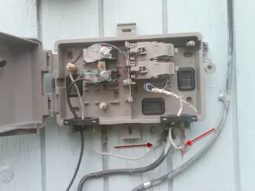

See photo below of the new one!
However this was not the issue. It was a initial installation flaw that cause the problem!!
The Telephone Interface Box must be grounded to protect against lightning strikes. It can be connected to the metal electric meter pipe or run into the house to be grounded on the electric circuit panel.
In my case it was brought into the house and grounded to the electric circuit panel. That is the best way.
The problem was the insulated one conductor ground wire went in thru the same hole as the telephone wire!!

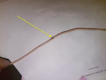

We found a small cut in this telephone wire just before it emerged from the house texture 211 siding! Even though it was a cut in the jacket of the 2 conductor wires, the red and green wires still seem to have their insulation in tact. Since there was some inside slack in the wiring he pulled it out about 4 inches and the noise problem vanished!! So I pulled out my drill and Insisted I drill a second hole thru the house and we ran a brand new wire from the now brand new network box to the connection inside my house and this problem will NEVER happen again!!!!
1st pic
Yellow arrow shows cut in outer jacket of telephone wire just inside the T211 sheathing. This was too close to the ground wire.
This hum and static issue occurs when The red wire is somehow shorted to ground!!!
2nd Pic
Red arrow shows new hole for telephone wire ONLY
Black arrow shows original hole where both ground and telephone wire went into!
Click to Enlarge pic

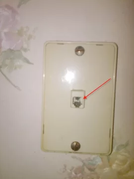

Well after a few days I was glad to have a line that was much clearer. Tonight I talked to a friend and it was great. Then I called another friend and the Hum was back with a vengeance!!!
It seemed different this time. More Hum and less static although there was some static. I could not hear my friend speak so again it was unbearable.
So I quickly got the phone and plugged it into the outside network jack. No Hum
Then I connected it to where the wire came into the house. No Hum (That wire was fixed!)
So I said, WTF - What has changed in the last hour to create this bad hum inside the house!!
Then I noticed a difference. Someone is taking a bath!!!
Well I have a Telephone Wall Jack in the Bathroom with NO phone attached!! The intensive water vapor in the steam getting into the open RJ-45 wall jack??
So I ran down to the basement and disconnected the wire to the Bathroom! Problem RESOLVED again!!
So here we have it folks!!
This thread now contains all the Inside and Outside causes of one of the 2 telephone wires (Usually red or green) shorting to ground causing a load hum in the phone line!!!
The line now is CRYSTAL clear absolutely flawless!!!
Thanks EVERYONE, we certainly learned what can cause a Hum and some static in the home telephone lines!!!!
See pic below of WET RJ-45 Phone Jack!!
