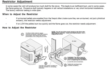

I have a current Lopi Yankee (this years model). I can not find anything in the back like you described. In addition, like the Avalon Astoria I have the restrictor on teh left side. The Knob on the restrictor arm just screws into it, and in order to open the left door the knob needed to be removed (unscrewed). Perhaps the previous owner removed it and lost it. The only other thing I found was that in a Travis trouble shooting guide I found, since it dates to 1999, it shows the restrictor as an adjustment on the Right side, behind the door near the front of the stove. It is adjusted with a wrench. I will try to post it here.

Hey JRB.....thanks for the pic. With my luck, that is probably where the restrictor is. Inside and needs to be adjusted with a wrench. I will probably have to call someone to take a look because I dont want to screw (no pun intended) with the wrong thing. -Diane

If there NO knobs of any kind on the outside, then I would look where JRB said with the picture above. Did you open the side cover to see if that nut was there? You could do this yourself....just make sure the stove is off, unplugged, and cool. Just move it one notch at a time, and let the stove run for a day or so.

OK, I'm assuming that what you found is the same as the diagram JRB sent above.....you need to pull the restrictor OUT. According to the diagram, you want to turn the nut clockwise. That opens the air inlet, and will make the pellets burn faster (and also will give more heat).
Use the little notches as mention in the diagram, and pull it out 1 notch at a time, and run the stove.
