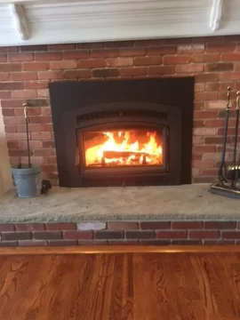

Hey guys, complete noob here so bare with me. I live in CT and have a 4500 sq ft home and am trying to use the oil furnace less for heat. So I just had a Lopi Large Hybrid insert installed into my mason fireplace. I have a few questions for you seasoned folks:
1. I run the cat up to about 1200 F and use kiln-dried wood so I try not to load too much so I don't run too hot, risking overfire...again I am noob so dont want to destroy it or have a chimney fire. Is that a good temp to peak for the cat? Should i run lower?
2. On cool down, when should I bypass the cat? At this time, I have been refilling around 300 degrees and will then bypass it for refill, then get it back to temp before engaging. Should I bypass around 200, 400?
3. For people who rely solely on wood stoves, do you try to run daily during the season? Can that be done with an insert without risking reliability?
We are happy with it so far but has been a learning curve compared to the open fireplace.

You must have the catalyst temp probe on yours, didn't have that on my fpx version. 1200F is fine, I would probably try to keep it under 1800F. These units are designed for 24/7 heating, but be careful not to let flames go directly into the cat. I would leave the bypass closed until you are ready to reload, then just let the new logs catch and close the bypass pretty quickly. This will allow for a slower ramping up of your fire and hopefully less flames going into the cat. Hope this helps, enjoy your beautiful insert!

Yes it has that catalyst monitor. TBH I had no idea it had one until the installer explained to me how to work it...like I said complete noob I just asked for a good American made insert that fills the gap and heats up the 1st and 2nd floor. My wife enjoys the warmth from it, a far cry from me always policing the thermostat.
As for the flames on the cat, I will try to keep the height of the stack no higher than the top of the bricks. Only issue I have now is that I can only get about 6 hours of heat from it before I reload..and that’s with me arranging the coals into a ball in the middle trying to extend the heat time of what just burned. It’s better than the open fireplace but I was under the impression it’s a good 8-12 hours. Someone mentioned the wood maybe burning too fast. Thanks for the tip Sailrmike! We are definitely enjoying the new found warmth, not to mention I find it fun to stack the wood, the loading , firing it up and watching it! There seems to be a technique behind it all.
