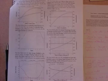

These calcs are for a 50 solar panel job in Eagle, Colorado. A DHW system to provide 200 gallons of 130F DHW, spacing heating for 10,000 square feet of home with a 212,000 BTU/hr load at -12F.
Various graphs show Solar Fraction and Life cycle Savings, Monthly Solar fraction across the year, Solar energy available at the panel and Space Heating and DHW loads. Collector Slope and Solar fraction. % increase in natural gas against solar fraction and Life Cycle savings, and building heat loss against solar fraction and life cycle savings.
Good to have data like this before you tie a bundle of cash into a system.

That looks very interesting, Eagle is a few thousand feet lower, but near the same latitude of the property at issue and not that far away. Breckenridge would be the nearest town people are likely to know.
I take it that was for a new build suitably orientated, that's a lot of square footage, our main building is at right angles to due south, has a clear aspect, but still a 34ft width.
