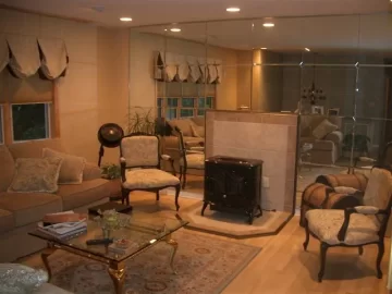

My local dealer had an inferno red model on display that he sold to me for the same price as the black, I can now plan on a complete room overhaul to match the stove. I am installing in the front room of a century brick so appearance was important, the output should satisfy my needs and was in stock and can go in ASAP.
Thanks for the replies.
I told my wife she could redecorate the livingroom to match the stove(as the oil company was indirectly paying for it)
I used 1100 gallons of oil last yearthis year $5.15 a gallon., now I expect to use 4 tons of pellets..do the math.
I think she did a good job.
