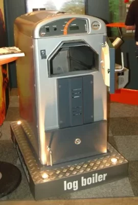

Here's a wood gasification/pellet boiler I saw at a trade show in Sweden that uses a Lambda. Like the Tarm, it's made in Denmark, I believe.
It's the Effecta Lambda.

The Euro styling is all over the map. I'm sure it plays "Burning Down the House."
