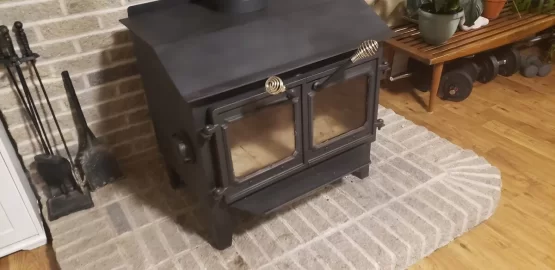

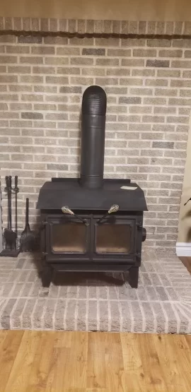

I have a Haughs stove, Model 42335 according to the plate on the back. It was in the house when I bought it, and I've been searching for quite a long time but can't find any information about it. I found out that Century bought the brand, but I've looked at every picture they have and can't find this model. I need to buy gasket for the doors, but don't know what size since there was none. and the gasket I used last year kept falling out. Not sure if that was a gasket issue or the cement I used. And it might be a long shot, but I would love to find parts for the blower motor, and a manual would be awesome too. Any help would be very appreciated!

Just bought a house with this exact model, had a couple late spring models but plan on using it for weekends/cold nights here in Atlantic Canada for the upcoming winter.
How do you manage air flow with the screws? Do you close one fully and then adjust the other? How efficient is the stove? Do you have trouble keeping the glass clean?

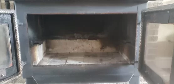

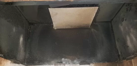

I have a Haughs wood stove different model. I would like to see the inside of your stove towards the top. It will help us to see what kind of secondary burner system this stove has if any. And a picture with the doors open towards the top to see what kind of air flow system they have above the glass.
Do these pictures help?
Should I have the glass sealed in any way? It's simply held in by the bolts
and there is red residue as if it was caulked at some point.

Yes those pictures are very helpful. The manual was also helpful as it shows to some degree how the stove is built. As far as a blower your stove may have a plate on the back which is removable for you to attach the blower fan. If your stove still has the plate you can get a generic stove fan and cut the hole the size you want to fit the metal plate on the back. It can be easily cut with an angle grinder. Or if the plate on the back is missing you can still buy a generic fan for wood stoves and by some sheet metal to fill in the gaps and make it work. I doubt very much you will find the original fan and if you do it will be expensive.
Take an old piece of the rope gasket with you to the stove shop and they will get you the right rope and casket cement. I like to use Ace in my area as they have many rolls of casket rope. You can also get the new gasket material for the window when you find someone that has the gasket rope.
It is a very nice looking stove but note as efficient as the newer stoves as it does not have secondary burn system which means you will burn more fire wood and put more smoke into the air. Just a heads up as you might want a little newer stove in the future. It will save on fire wood and you will get longer fires in the stove.
As for the glass window it does not appear that you have any air wash system over the window so the glass will not stay clean as long as a more modern stoves.

I just looked at your pictures again and you air comes into the stove from those two large caps that twist on the sides of the stove. This is what is called your primary air intakes which adjust the temp of the stove. You start the stove up with these open and then start turning them down as the stove heats up to regulate the temp. My stove has the air intake coming in over the window to keep it clean. With most wood stoves they keep making improvements on them and yours seems to be an older model. If you have the money you should look into getting a newer new or used stove. I just purchased a nice EPA rated stove for $175.00 on Marketplace which has the window air wash system and the fancy secondary burn tubes. I will be installing it today. If you have the time you might watch some videos on secondary burners for wood stoves. They also have what is called the catalytic wood stoves which another learning curve.
