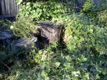

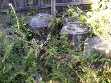

My bro in law cut a big oak tree about a year and a half ago. He left these massive stumps in his back yard. I have no clue how im gonna cut these and take them to my house but i will find a way! anyone got any good ideas! By the way im a newbie at this!

splitt them where they sit
These things are massive the look lil in the pic but they are pretty big. How would i even start spliting them? Axe? chainsaw? im new remember!

That pic must be deceiving because I'm looking at the fence in the back and thinking that post must be about 4", I then use that to measure across one of the rounds (one on left in first picture) and it comes out to about 20 inches.
When I bought my home 3 years ago I was left with a similiar situation. Some of the trunks were 44" across. I have a craftsman axe, maul, sledge and a couple of steel splitting wedges. My method is to try to find a crack or weak spot and bury the axe as deep as possible into the log. I use the sledge to bang the head in all the way and then the wedges to hopefully pop it open. Each log is different and some would split in two and others, well lets just say were a lot of work. If the logs are more than 20" long you have your work cut out for you. I would split them where they lie to save on some work.
If it is Oak it will split fairly easily. Get a maul and whack it, you will be surprised.
Get it out of there soon for some reason Oak does not last laying on the ground.

just start on the edge and take pieces off. try not to think of splitting as "bust it in half" and then "bust that half in half" etc.
So... dont split in half cause its not going to work on these monsters! To me they are monsters! Ill try and play this weekend. Good luck to me!
Oh yea and as Danno77 said do not hit it in the middle with the maul, hit it half way between the middle and one edge, if you get a crack it will travel through the middle. the middle seems to be softer or something. It just splits easier not going for the middle.
Oak usually splits rather well with just a wedge and short-handled maul, too.
You might want to flip them over and evict the worms and critters if they've been there that long.
I got a dollar says they're punky.

Carlos, I've scrounged some wood like that. With the vines & stuff growing on it, its probably not dry. But if its not punky, its worth taking for next year. Like Danno77 says, don't try to split them in half, but attack the edge with your axe / maul. Its common to try to make big pieces first, with one mighty swing. That don't work. Trust me, I've tried. A lot. Smack small pieces off the edge, like your axe/maul is the vertical bar of a D and the edge of the round is the curve. Or maybe more like |). Work your way around the round this way.
these vines to to that part of the back yard just this summer. My bro in law actually let his yard over grow this summer thus the vines we have in the pics! There are actually more stumps to the left of those, i just didnt take pics, i thought these were sufficient to show!
