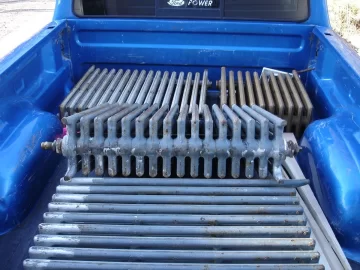

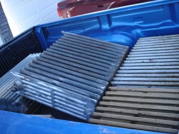

Picked these up from downstate, the guy had a 16 more, but they were all tall and the "Victorian" style with all the scroll work and curved tops. These were the smallest 4.
I'm going to sand blast them this weekend and paint with automotive single stage, an off white per the Mrs. request. You can see I have some bushings and the adapter to air pressure test before I invest any time in them. If they hold air overnight, then they'll move on to blasting.
These will be in the kid's bedrooms up stairs over the garage. They will each be fed via 1/2" copper fed reverse-return from 3/4" main from respective Caleffi zone valve.
I've already had a couple of people eye them, hmmmm, there are more, but I need to get (borrow) a bigger truck![Roll Eyes :rolleyes: :rolleyes:](/talk/styles/default/xenforo/smileys/rolleyes.gif)
