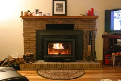

Well now... Long weekend for the Thanksgiving holiday, and after a few setbacks and a couple of sidetrips, I finally have the insert burning and a few extra minutes to post pics... That's one more thing to be thankful for... ![Wink ;) ;)](/talk/styles/default/xenforo/smileys/wink.gif)

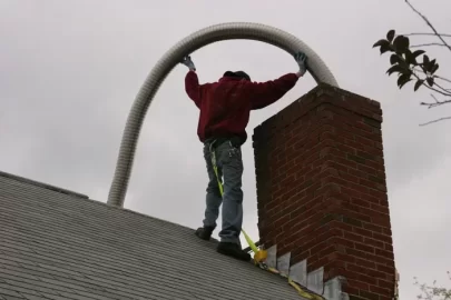

First pic is our own GVA stuffing the 6inch liner down my chimney - at this point there was enough pipe on the roof that I could go down the ladder and grab the camera....

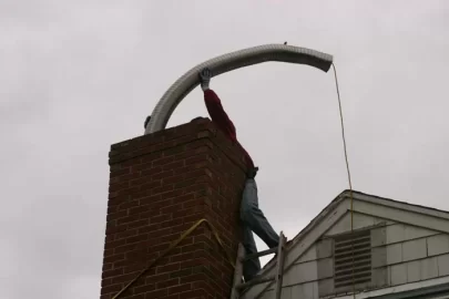

Second pic: the liner is most of the way down the chimney. GVA is still up top and Elk is inside at the fireplace. With GVA pushing and Elk pulling on the rope, they work the liner down past a chunk of mortar and past the offset.

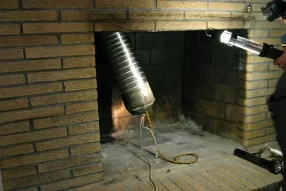

Third pic: Elk and I had ovalized a few feet of the liner to enable it to pass through the existing damper opening. Here is the liner poking down into the fireplace opening. You can see the "cone" the Elk made, and the rope inside that is tied to some large steel washers. Without the cone shape and the rope to haul on, we would probably not have been able to get the liner down this flue.![shock !!! !!!](/talk/styles/default/xenforo/smileys/shock.gif)
