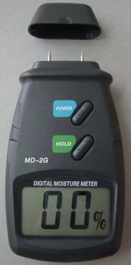

SEASONED WOOD SHOULD START BURNING AFTER IT'S PLACED ON BED OF HOT COALS IN LESS THAN A MINUTE !! FRESH CUT WOOD HAS A MOISTURE CONTENT OF UP TO 50 % GOOD SEASONED DRY HARDWOOD SHOULD BE 20% OR LESS !! YOU KNOW MOISTURE METERS ARE NOT THAT EXPENSIVE YOU CAN PICK ONE UP ON EBAY FOR 20.00 OR SO...IT'S FUN TO PLAY WITH. INTERESTING TO CHECK DIFFERENT LEVELS IN WOOD PELLETS ALSO ....
