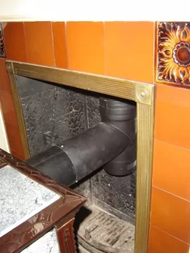

What do you normally do at the bottom of the tee? Does it need to be supported or just hang? the tee will be 6" or so above the bottom of the clean out.
The tee also came with a bottom cap. Is it advisable to leave that on?
The liner is supported by the top cap. My top cap had a band that got tightened on the liner to hold it and support the weight. The T needs the bottom plate or the liner would not be sealed and would pull air from that.
Yeah the liner supports (hangs, really) from the top. at the bottom you'll need a sheetmetal blockoff plate (above top of firebox, essentially) and the tee below that. Not sure what you mean by "the tee will be 6” or so above the bottom of the clean out."
The bottom of the tee has the cleanout cap which absolutely needs to be screwed in place.
Edit: added a pic of my tee & cleanout cap. There's a sheetmetal plate just up inside the box that the liner goes thru, and we put a band clamp above and below the plate to hold it tight, then screwed the plate into the sides of the firebox.
