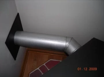

As you can see, there is not a clean out T. The stove is on a 45 angle in the corner so the pipe bends and then vents horizontally out of the house. Apparently the installer had to use the 90 and 45 in order not to hit a stud with the wall thimble. Perhaps in the future we could instead put a clean out and use a flexible vent, if there is such a thing. Any advice on how to clean this would be appreciated. Do you use the ash vac? Does it need attachments? Thank you guys!

Mine is almost exactly like yours and I did not need the 90 degree elbow. Yours looks closer to the walls. If you are willing to pull your stove out a bit you could remove that 90 degree elbow. Here's mine.
