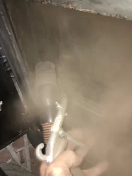

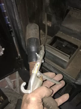

Hello, welcome to the forum. Nine out of the ten times this issue is caused by restrictions in the air flow ( exhaust is clogged up by fly ash and needs a deep clean ).
Your Montage pellet stove is very service friendly with ash clean-out ports and all ( unlike my Quest Plus

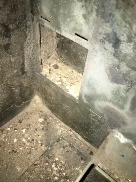

). Have you cleaned behind the ash clean-out ports?
Ash Clean-out Ports on a Lennox Montage:

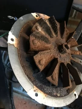

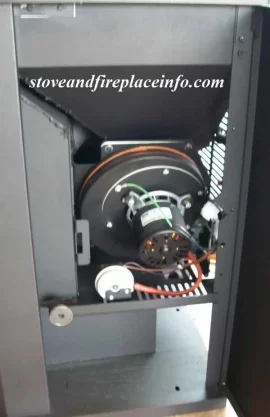

Have you pulled the combustion blower ( held in place by six nuts ) and cleaned the impeller and the blower housing? A lot of stuff build up in here that will restrict the air flow.
Combustion blower on a Lennox Montage:
