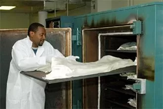

Here is the guy making the blankets that insulate the nose of the shuttle. I ain't buying that there is asbestos or any other hazardous material in that ceramic blanket he is working on without a respirator.

BB, the nose cone of the shuttle is in fact one of the special areas which have carbon fiber composite that can withstand over 2000f. If they put blankets in there it is all secondary insulation, not primary. Nasa has a ton of contractors. Saffil actually had a new primary heatshield made of laminated alumina fiber on Challenger. Unfortunately they blew up on the way out and the new heat shield was never tested. Since the disaster they decided not to try new ideas and so we had the second disaster with the damaged tile. Maybe if the first disaster hadn't happened, we would have had a new heatshield on Columbia and the second disaster might hot have happened either.
