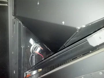

The hose goes from the switch in the back, up to the side of the auger chute. Mine is on the left side, when looking at the stove. Mine is a freestanding, but the hose location should be the same.
I pull the hose off of the switch instead. Then blow through the hose and it will clear the fines out of the end. Then leave disconnected while cleaning and using leafblower.
Edit : Pic added. This is what the switch may look like (depending on how old the unit is).
