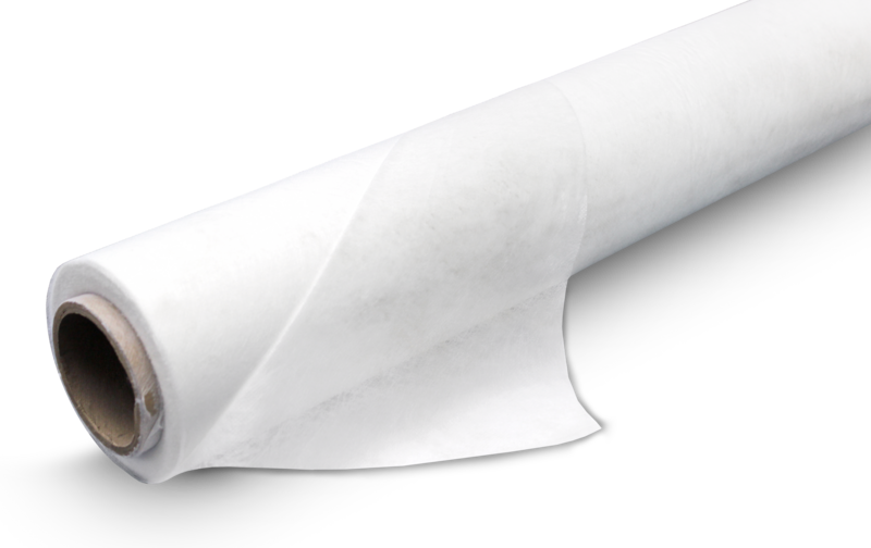

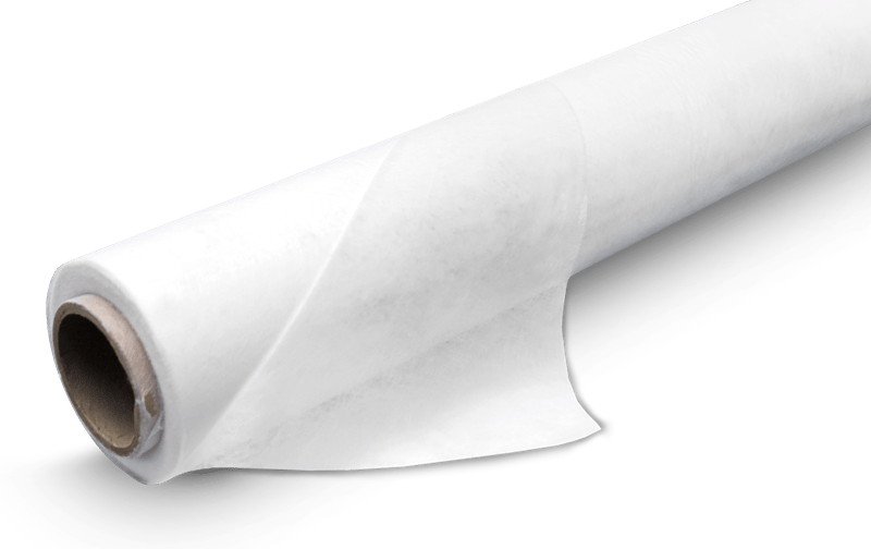

You may be thinking of this product. A local guy said that landscape fabric works just as well, but that's just one man's opinion.
