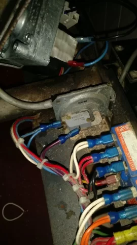

Hi,
I have a similar problem, i had a bad bag of pellets which caused my auger motor to burn, i have now replaced the motor (tested with direct power from outlet and it turn with auger as well) , but now i don't have any light in the back, both exhaust and fan motor are working but my auger motor won't turn.
The vacuum disc seem to be working fine but when i unplug the vacuum hose both top light turn on.. No flashing of any codes
Bottom light doesn't light up.
I did try to bypass the snap disc (if that the little sensor with a red button that can pop out) it didn't help..
Im wondering if it could be one of the 2 blue modules?
Could someone confirm my vacuum switch is connected correctly?
Thanks in advance for your help!!
