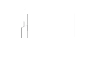

does it look like this?
It sounds like you're blowing very hot exhaust gas into the side of your house, with that sort of cap. I wouldn't even THINK of starting the stove until this is fixed.
I looked in the directions, and couldn't find a horizontal space limit for a vertical chimney. I'm sure there is one...maybe one of the pro's can chime in. With a wood burning chimney, that has to be the highest thing around for somewhere in the vicinity of 10 FEET.
Home Depot sells both 90 degree elbows, and horizontal caps.
Yep, it looks like that... I checked with the place I got the stove and they said in their book from the manufacturer that there was nothing in there, so there were no clearance issues, other then the pipe, which is 3" - I checked it this evening when I got home and everything seems OK, I did get 2 - 45's though to move it out further away...
