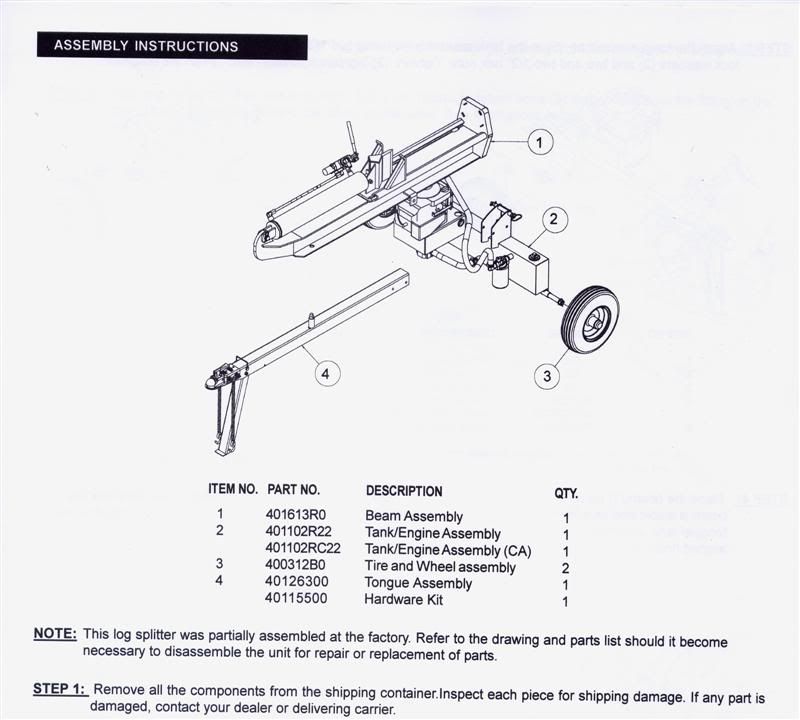

According to the manual, there are only five parts to assemble....two wheels, a tank/engine assembly, a tongue assembly, and a beam/ram assembly. I believe the engine and tank are already assembled and thus the coupling is already assembled.
I don't think this one can be attributed to TSC though I wish it could be...I believe it's a Huskee issue. I've notified the Speeco rep and hope he will join the discussion, he is a good, upfront type of guy. He probably won't see my email until in the morning.
TSC (not the Greenville store) was assembling one for me tonight...I'm supposed to pick it up tomorrow evening. I've gotta think this over a bit more now since lukem has had the same experience as I had.
I wrote more but deleted it, it wasn't constructive...
Ed
ETA: Add image of parts of splitter to assemble.
