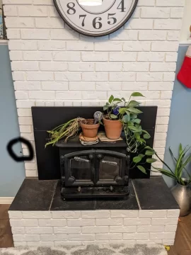

Recently moved into an older ( 1973 ) home. At some point, the fireplace was converted to have a wood stove. As best I can tell, the model is a 1982 Lopi X.
I will try and attach a pic to this post.
I just had a chimney sweep come by to evaluate "my situation".
Details:
- The stove is in the basement level of the house (half underground). Concrete floor.
- The brick chimney extends up the side of the house and goes well above the roof line.
- As it turns out, this thing was basically "shoved in there". It does NOT have a liner that goes to the top of the chimney.
- I found the original manual. The stove was installed with acceptable clearances in all but one way. It should have 41 inches of clearance in front of the stove. I only have a couple inches.
- The original fireplace flu is still intact. The stove also has it's own flu.
- In my picture, I circled what I'm told is a gas valve for a "log lighter". This was used in the original fireplace to pre-heat the chimney and prevent smoke coming back into the house?
- When I insured my home, I mentioned we had a fireplace. Nothing else was said.
The sweep was careful with his words and suggestions ( I gather this is to prevent him from being implicated in any insurance related matters etc ). But here are my options (as far as I know):
1) Have a full liner installed. I gather the original flu would be removed etc.
2) Remove the stove and restore it back to a traditional fireplace. Additionally get the log-lighter working.
I'm looking for any advice/thoughts.
What would you do?
Pros and Cons as I currently understand things:
1) stove puts out heat (pro)
2) stove doesn't have the required clearance in the front according to manual (con)
3) restoring to a traditional fireplace may be cheaper? I didn't get any quotes. I don't mind doing some of the work myself where I can (pulling old stove, putting mesh curtains on etc).
I don't really know how I plan to use the fireplace or stove. How many times a year? Not sure! I've never owned a fireplace or stove to know just how much I'm going to fall in love with it and therefore use it.
Thanks!
