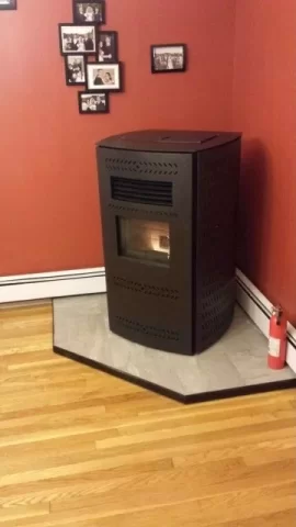

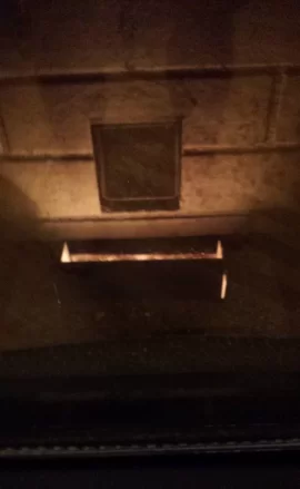

ok so got my stove on friday and did the outside burn in my garage and everything seemed fine . installed it last night and started her up i used the 3" pipe kit from amfm just adding another 90 degree bend and the oak. it was 59 degrees out so i kept the setting at 1-1 first thing that happened is the door latch came undone stopping the feed and killing the fire, re-latched the door and started it up again stayed burning for maybe 2 hrs but there is no flame i can see sparks and a red glow. i turned the settings to 2-2 and got the same results i figured that it was just because of the low settings and passed out on couch after a hr the fire was out.. i again cleaned all the un-burnt pellets out of burn put and restarted it this time i put the setting to 6-6. even with this setting i really did not have a visual flame all the time i would see it for a few seconds or untill pellets were fed to pot, the door sprung open again after a hr stopping feed but this time i caught it in time and the fire stayed going..anyway went back to sleep and woke up 3 hr later with the fire out and a bunch of pellets all in the pot and ash tray cause the auger kept feeding them after the fire was out ..
the glass is dirty but not black
lower 3 buttons are on 4-4-1
and the latch i have no clue why that springs open i made sure it was closed every time (i am gonna try grinding a little seat for pin to rest in hook
