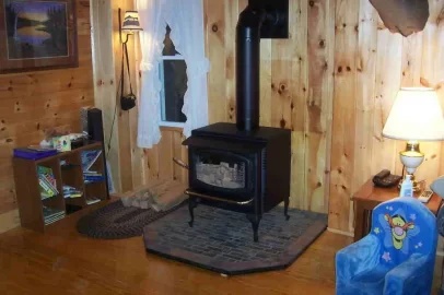

Well, its official. My new Avalon Rainier has been installed, along with an American Panel hearthpad. HAvent seen them yet, still at work but am anxious to check it out. A couple questions for you steel stove burners..What process did you use for starting the first fire, how many low fires did you have an when did you ahve the rager?

is there any way to put pics on this site?
hope this works!
  • [Hearth.com] JUST INSTALLED - AVALON
haha..there is a reason why I cut it off! Cant tell my secrets! nah, its jsut a small 8 pointer I got wit hthe smoke-pole a few years back..
