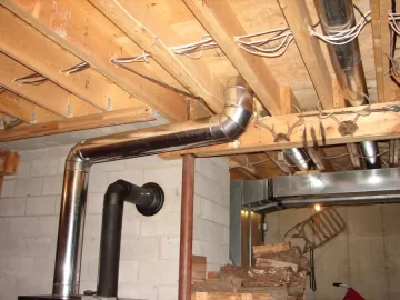

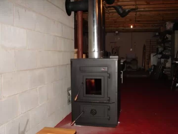

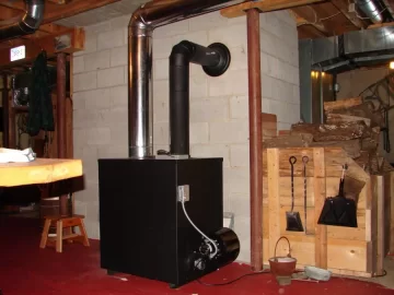

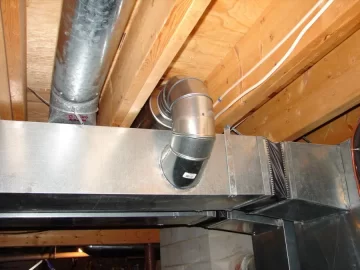

The install was a breeze. The furnace is working great, but haven't had any really cold weather yet. At 28 degrees at night, it's 72 in our 2,000 sq. ft. log home. I'd say that's pretty good. I've attached some pictures. Let me know what you think of the install.

Nice install! Thanks for sharing. 3 questions.
1. I notice you went with straight galvanized pipe for the hot air duct...did you notice the install instructions say to use black pipe for the first couple of feet? Several people have done it just like you, so I don't know how critical it is. I think it's mostly important for running the stove without power (e.g. no blower moving air).
2. Did you constrict the duct from 8" to 6" when you turned the corner to enter the main supply duct from your furnace?
3. Not really a question, but it seems the furnace is facing away from the wood supply...I assume it's so you can see the door from the stairs or something, but too bad you couldn't get the supply closer to the furnace...
Sorry, one more question:
4. Were you able to maintain clearances for the full run of the air duct? I've been wondering about duct temperatures downstream. Have you made any measurements where you have wires running nearby?
Thanks again.
Thanks for the compliment on the install.
Question 1: I did read that, but didn't think it was a big deal.
Question 2: Yes, because I couldn't find a take off vent that was 8 inch.
Question 3: It's facing that way because I wanted to have the bulk of the furnace with the clearance near the concrete wall.
Question 4: Not sure what the clearances are, but I can hold my hand on the ductwork during full usage. I've had hot water baseboard heat touching wooden surfaces that I could not touch the pipes, so I'm assuming this is OK.
