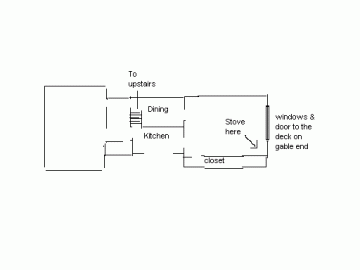

Welcome Herv. I'm curious about how large an area will actually be heated. Are the kitchen and dining rooms on the same floor level as the family room? How large are the openings between these rooms and the family room? Assuming we can help with heat distribution, how large an area in total will be heated? Also, is the family room floor very well insulated and sealed from the garage beneath it? ( a sketch of the floorplan would help here.)
As far as the stove installation, will it have a straight-up flue or will it head outside and up the side of the building? The later will affect draft and may be why the F400 was discouraged. It likes to vent straight up to a 15-20 flue ideally.
There are your basic doorways into the kitchen and dining, with doors that can be closed. The floor is insulated. The pipe will go straight up from the stove through the roof with no bends, and above the roof will need to clear the peak by 2' so I'm guessing top of the stove to the top of the flue will be about 16'. I was thinking about a doorway fan in the dining room door to pull air out, and maybe even a second in the door to the hall so that heat could move upstairs. However, I'm concerned about fan noise and the draft created.
I attached a rough .gif of the floor plan.

Oops, forgot to add: The kitchen and dining room are on the same level. The square footage of the FR is a little over 300 (but with 12' average ceiling), and the dining/kitchen probably adds about 200 sf with 9' ceilings. If heat got beyond there, it would head up a stairwell with lots of rooms off it.

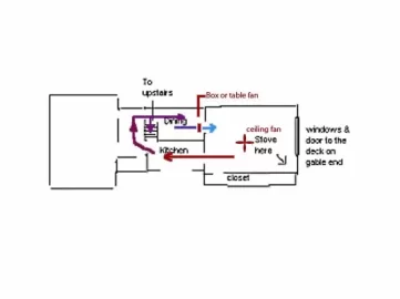

As far as heat distribution, I think you can make a nice difference with a ceiling fan (blowing upward in the winter). This will break up heat stratification at the ceiling peak. And I would add a single box, or table fan on the floor in the DR to create a circulation pattern. Blow the cooler air towards the stove and it will be replaced with warmer air drawn through the kitchen. It seems odd, but this does work. We have several users getting good results this way. In our house this is how I now heat my office using a standard 12" table fan on thr floor. I have it on low and never hear it running over the computer.
If you are worried about the size of the fan, we have had reports of this model working well for people. Put it on low speed and the noise will not be as big an issue. https://www.hearth.com/talk/threads/26587/.
Another plan would be to get a stove with a blower (F500 or T5) and locate the stove so that it's blower output is directed towards the kitchen opening.

Would moving the stove closer to the kitchen help, in this scenario?
