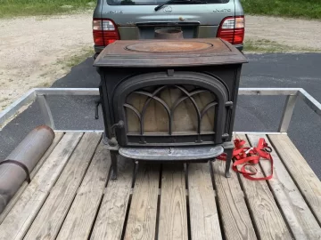

I recently purchased an Oslo F500 (for $400). There's a good bit of surface rust...but it's coming off nicely with a couple wire wheels. I still need to get the top off...but the nuts are pretty much stuck. I'm planning on soaking with PB blaster to see if that helps. I may end up trying to take the oval off so I can access the internals, clean and replace the blanket.
Here are some pics...let me know if you see something I don't. :)
Unloading 450lb stove...by myself.

Your work is cut out for you. Please take the time and do some photography during the process! Thanks for Sharing. I look forward to your end results.
FYI...the rust is coming off relatively easily - it looks worse than it really is.
I'm wondering if I can get by not having to completely disassemble the stove this season. Can I apply furnace cement kinda like caulk in those areas where it has flaked off?
It looks like it might be worth a total disassembly in order to seal the seams well. Otherwise, it's just a patch job. Try to get some Hearthstone stove cement. It's close to the original Jotul cement.
(broken link removed to https://rockymountainstove.com/hearthstone-furnace-cement/)
Dave, you can slide the burn plates out to the front of the stove. You don't need to take the top off. Unless there are other issues. The insulation blanket can folded and slid in place.
Hows the burn plates? They can warp.
I agree with begreen I would do a full teardown
The griddle and top are pretty easy to remove if you can get the bolts loose. A little heat from a propane torch may help with that but not too much. Cast iron doesn't like to be heated unevenly and can crack when it is.
I'd grind down the casting flash also to create a better seal at gasket surfaces. I disassembled my Oslo a bit during its install. There are some photos here: https://www.hearth.com/talk/threads...oslo-liner-and-stove-install.38467/post-38467

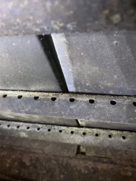

Secondary burn tubes and other internals have some surface rust...but all is solid. Don't think I need to worry about
deep cleaning it...do I?
[Hearth.com] Jotul Oslo refurb has begun...
I'm guessing they had a kettle of water boil over...and didn't do much clean up. Speaking of 2ndary burn tubes....
can someone explain to me where the extra air comes from? Do I need to remove the back to access that area to clean?
Air intake was clean.
