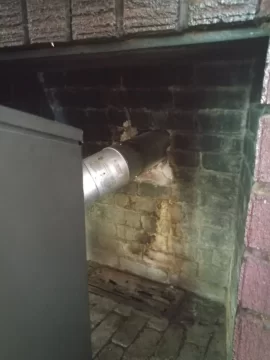

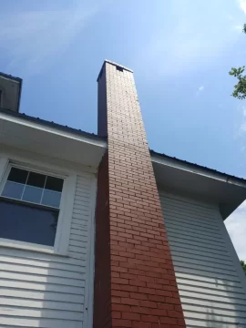

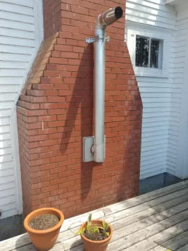

Anyhow, because of the way our chimeny is we would have to have some serious and destructive work to vent through it. Instead we want to expand on the hole the pellet stove left in the chimney and run it outside the house. It is not ideal, but it is all my partner is willing to do because we don't want to do any more damage to this beautiful old four square, historic house.
So we need a rear venting stove. I am thinking Jotul F55 because I think it is the most powerful Jotul. Is there a more powerful rear venting stove? We fought tooth and nail with a pellet stove, space heaters and rads last year and were always around 15C or 60F. This year we want to be warm. Hot even.
