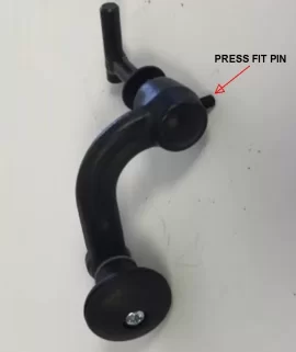

Just another bit of information. Over time I found that the side door handle would start to turn hard and seem to bind. No amount of graphite helped. I was able to take a punch and drive out the press fit pin holding the assembly together, remove the works, sand the handle shaft and the hole it went through with emery cloth, coat it with graphite and put it all back together. Really improved the situation. Evidently the steel used for the shaft is able to rust slightly, or at least that's what it seemed like. Buff it clean, and it's back to running smooth again.
