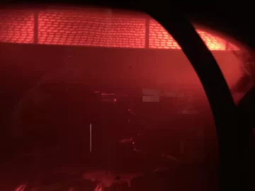

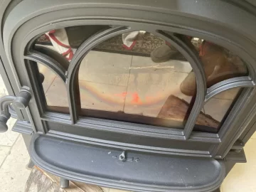

Something Id not see before. I dont know what wood I have here, evergreen tree and smells nice like maybe pine , but I put three 22" splits in this new F500v3 and it visibly burned for a 20-30 min and then I cut the air to zero. fire went out but then there was this ghostly glow I noticed walking by. Got down on my knees to see this! CAT at 1000F. No fire. The glowing lasted about an hr and calmed back down. This wood is well seasoned and about 10% moisture. Splits easily even if the log is 22" long. I also notice the top back of the stove surface temp was 450F and the top front about 250F. Back always hotter than the front. ![[Hearth.com] Jotul F500 break in procedure [Hearth.com] Jotul F500 break in procedure](https://www.hearth.com/talk/data/attachments/302/302693-39717052dbc12da72a3117dcf1533c06.jpg?hash=WGe-iPPjG0)
