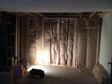

Here is what I am looking at. I was hoping for a straight run from stove out through the roof. The second picture is the crawl space that the insulated pipe is running through. If I keep it 2-4inches from the front wall I have about 12 inch clearance to the back wall. Like I said I was hoping to use 24 ga I. The living room but May have been dreaming. What is the clearance from veneer? Still 18 inches? Does double wall pipe still throw a good amount of heat into the living space? Thanks for the info begreen. Heat shields probably aren't for me, but at this point I'm open to anything to get this thing back in the house and running safe and efficiently. [Hearth.com] Jotul f3 clearance help [Hearth.com] Jotul f3 clearance help

Of course, you said it in the title. ;em That's a pretty small stove. If you want more heat, I would look for something bigger instead of trying to coax each last % from that small stove. Creosote builds up when flue gases cool down below 250 F as water vapors start condensing on the flue pipe. If you cool the flue gases too much in the lower section, they may not stay hot enough up to get to the top above 250 F. That small stove will have some difficulties pushing enough heat up the flue as it is.
My house isn't that big grisu. I used the stove last year and had it running with a ten foot liner up through the existing fireplace flue. I ve since tore out the fireplace and been looking to hook it up correctly. I don't think it drafted that well through the fireplace flue and was probably losing a ton of heat through the damper, but it kept the house pretty warm except for a couple of the extremely cold days. I'm guessing it's going to be much more efficient this year. I'm still trying to figure out exactly what I need for clearances. It says in the jotul pamphlet that I have with a double wall insulated chimney connector I can get the rear down to 10". Nothing about single wall pipe. Since I ve already got some money into some nice 24 ga I'd love to use it but don't know exactly what I would need to do to make that happen. Sounds like I should just get double wall. I'm guessing with the double wall I can just go with the original plan of hanging cement board and veneering it as long as it's a minimum of 10 inches away.
