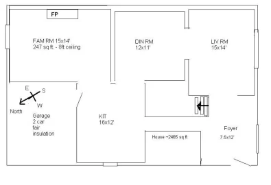

I'm uploading pix/house layout below for best advice between F3CB vs Castine F400 (hopefully they uploaded correctly)
House: its called a "carriage" house or duplex (two houses squished together). ~2465 sq ft, 2 story, 1989 construction, good-fair insulation. We do not have a open floor plan, and can only place stove in Fam Rm against wall. Good thing is Fam rm faces north (no sun from Oct-Mar), cold side of house, alongside of garage, one sliding glass door recently installed Anderson well insulated, normal 8' ceiling. Two registers and two return registers are opposite side of room to help circulate, and will be installing ceiling fan. Existing system is HP (forced air). The wall running from fam rm to living rm is an insulated wall adjoining our neighbor, so opposing rms are the the exposed areas.

The issue appears to be to get rid of the compartmentalization of the current floorplan. Is there any chance of putting an opening between the family room and the dining room? If this opening could be in line with the opening to the living room, then I would go for the Castine or perhaps an Oslo. It will provide longer burn times and have more reserve for the depth of winter. In that case, you may need a fan in the living room, pointed toward the family room to assist circulation, but that is not a big deal.
That wall carries all the sewer/plumbing between 2nd floor and basement (2 bathrooms are above that wall between fam/din rm), so no that cannot be removed.

With either stove, a 35' liner chimney run is going to cause A LOT of draft. You might have to consider a smaller than 6" liner. Since you cannot remove the wall between the LR/DR, a bigger stove might cook you out of the LR. Just something to consider.

I wasn't suggesting the wall removal. It is likely a supporting wall as well. However, is there an option to open the wall up a bit? I was thinking of a large opening similar to that on the LR/DR wall. If there are no drains in that section, then it may be possible to open up Supplies may be relatively easy to reroute around the opening. Just a thought. It would definitely improve air circulation.
