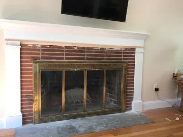

Hi all, I'm thinking about getting a Jotul F100 in the future to heat an open concept area of my house. This would be used as a supplemental heat source and used mainly on nights and weekends. The area is about 600-750 sq feet and features a dining room, kitchen and living room all of which is open. I've checked the clearances of the stove for an installation sitting outside of the fireplace. I think I meet all but one which is the lower trim of the mantel. From the floor to the bottom of the lower trim I measure 38". Given that the stove is 22.5" and there needs 17" from the top of the stove to the bottom of the lower trim that gives 39.5" of clearance. The lower trim juts outs 1.5" and the top of the mantel juts out 4".
Can anyone suggest something to make this stove fit the requirement? I was thinking a 22ga piece of sheet metal on the bottom face of the trim and then painted with rust oleum high temp paint? Would this work?
Thanks for any feed back.

Yes, you could fabricate a mantel shield that could be attached to the underside of the lintel or to the underside of the bottom mantel trim with 1" spacers.

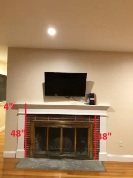

I re-measured the mantel height from the floor. I’m at 46” not 48” so the H200 is a no go. I think I’m going to move the bottom trim up 2” and that will make the clearances for the jotul f100 and the craftsbury good. Any other suggestions? By the way, the dimensions of the firebox are:
Height - 29" in the front and 32" in the back
Width - 48" front 36" back
Depth - 21" and 16 7/8" hearth
Floor to bottom trim = 38"
Floor to bottom mantel = 46 3/8"
Alrighty, I moved the mantel up a bit and now have 40" from floor to bottom trim and about 49" to the mantel shelf. The jotul F100 will fit just fine with these specs. I do like the look of the stove and the large fire viewing window. The short burn times seem to be a problem with this stove, but I am using it mostly for ambiance and supplemental heating nights and weekends. Is there a stove with similar clearance specs, a bit longer burn time or more BTUs, but also aesthetically pleasing? I've read an old thread on here that mentions a quadrafire yosemite but looking at the quadrafire website they don't seem to make that model any more?

@begreen I just looked at the clearances for the mantel and I don't think that's going to work. The lower leg kit reduces the height of the stove by 2 1/4" so given the height of the stove at 28.5" I wont be able to fit it.
Mantel and Trim Stove to 1" thick or less, side trim - 13" this is ok.
Clearances Stove to 1" thick or less, top trim - 23" + 26.5(low leg kit) = 49.5" I'm at 40" from floor to bottom of top trim (unpainted wood in picture)
Stove to mantel- maximum mantel depth 12" - 25" + 26.5(low leg kit) = 51.5" I'm at 49" from floor to bottom of mantel.

I was thinking of the F400 with the short leg kit and the Jotul heat shield installed. Ask your Jotul dealer.
@begreen Is the heat shield removable when not in use during the warm weather? I could get on board with this and hopefully get the wife approval too.
Yes, it could be made removable. Or depending on the mantel design one could be fabricated to be quite discrete and inoffensive. Or the mantel could be made of a non-combustible material.
I wondering if I could find a metal fabricator in my area to make something for the mantel. I would then need 1" ceramic spacers to have the metal attached the wood mantel correct?
Yes, if the mantel material is combustible then the shield would be attached to the underside on 1" spacers and it would extend an inch beyond the mantel. It's just a sheet of metal cut to fit. Could have the front edge angled up slightly and could be painted black or brown to make it more discrete or made out of copper if you want to get fancy.
