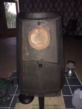

Trying to install a Combifire 4 that I bought used. The stove is in good shape with no cracks.
I measured the inside diameter of the flue collar and its 6 5/8 inches. Woodsmans parts plus has a stovepipe adapter for the Combi 4 that is 175mm to 6". Did I measure the wrong thing? If the adapter measurements are correct do I then need 6" stovepipe?
This is my first install so pardon my inexperience.
